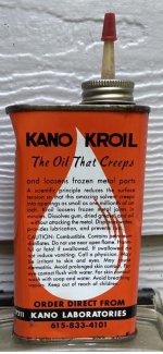

I bought a Mossberg 500, 20 GA. shotgun with 3 barrels. One barrel is a 24" Slugster; self explanatory. One is a 26" Accu-choke with no chokes for it, just a vent-rib barrel with a white BB on the end for the sight. Now, there's a 26" barrel called "C-lect Choke." I can't find diddly squat on the net about it, and customer service said that wasn't with the gun. I did find something about a different brand shotgun with c-lect choke, an older brand Mosssberg doesn't seem to make anymore, but the barrel fits just fine. I can't turn the adjustable choke by hand & I don't want to mess it up with the tools I have. Of course the gunshop doesn't know anything. I don't hunt or shoot clay, I just bought the gun for I don't know why...home defense? And, of course all the 18.5" barrels are out of stock. Info on the C-Lect Choke is basically needed. The gun was built in 2018, for what it's worth, and it's all plastic or whatever, not wood.

I ordered my 18.5 barrel direct from mossberg couple years ago about 75.00.In the 26 barrel smooth bore slugs shoot great with imp cyl and i got a super extra full turkey choke only 2 chokes i use.If barrel is threaded i would use a choke to protect threads.You are going to need to soak the choke in kroil so yo can turn it.
As mentioned above, soak the choke in Kroil. It might take a few days to loosen up. While not aesthetically pleasing, the things actually work pretty well. I pulled these photos from a 1974 Mossberg catalog. Having a barrel cut and crowned and the bead replaced can be costly and may exceed the price of a new or lightly used barrel.

If the tube is jammed, try some oil on the joint inside and out.
Wra the tube in some leather. Clamp tight enough to keep it from turning in a vise and try unscrewing (RH thread)
Or use a large pliers to do same.
Maybe someone jammed the tube down all the way hard thinking they'd get an Xtr'ee Full Choke that way.
Once it's off..clean the threads on the tube and the bbl base off. Also the 3 or 4 'fingers that are on the bbl base. Make sure there is no damage or anything jammed inbetw the fingers.

I do like this shotgun. I sprayed the choke with Kroil and it came loose by hand. I think somewhere up above it said to use lead shot only, as steel will hurt the barrel. I thought all shotguns made recently (this one 2018) are good to go for steel, as lead is outlawed for birds in most places. Maybe this barrel with the ancient C-lect choke can't be used, I don't know its age, but I really just want to find an 18.5" barrel for a house gun, and maybe take up rabbit hunting again. Apparently Buick has no problems with steel, so I'm cool with that.
