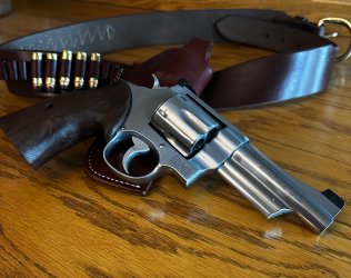

I picked up my first mountain gun today. The 629 44 magnum. I haven’t been this excited about the release of a new firearm in years. The nice partridge sight with a gold bead creates a great sight picture. For years I had wanted one, my neighbor had one in 45 Colt at one time that I had fallen in love with. I hope that keep this series going and put in a 45 Colt at sometime. The Tyler Gunworks bear hug grips fit beautifully and look like they belong, I feel they are much better than Altamont. The gun locks up nice and tight. Looking forward to a range day this week. IMG_4914.jpegIMG_4912.jpeg

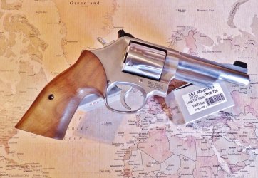

I had one of the original/686-5 Mountain Guns and wished I'd never sold it. So when the new MG came out, decided to buy one. So far, quite happy with mine. Front sight is very tall, so mine shoots low, but no worries, I will fix that.

I've had my MG to the range now a couple times, using .357 and .38 Spcl. factory ammo. As I mentioned, POI is low, but otherwise everything works quite well. Glad I bought it, and have no desire to sell or trade it on the next shiny thing that catches my eye;)

I picked up my first mountain gun today. The 629 44 magnum. I haven’t been this excited about the release of a new firearm in years. The nice partridge sight with a gold bead creates a great sight picture. For years I had wanted one, my neighbor had one in 45 Colt at one time that I had fallen in love with. I hope that keep this series going and put in a 45 Colt at sometime. The Tyler Gunworks bear hug grips fit beautifully and look like they belong, I feel they are much better than Altamont. The gun locks up nice and tight. Looking forward to a range day this week. View attachment 771355View attachment 771356
