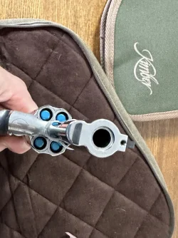

Sounds like it's "within Colt's Acceptable Standards " I sent back 2 King Cobras and 1 of my Wife's King Cobras a year ago! The bores were all crooked and either the barrels were too short or the barrel shroud was too long. None of the 3 fit flush together, unlike my Anaconda or my 2 Pythons. Apparently they were in acceptable standards. 🤬 my 3" KC was a Talo exclusive. They couldn't even get a loan number of exclusively produce revolvers to be quality made. this explains why Cole keeps going through bankruptcy. CZ needs to build a new plant down south and fire all those garbage union employees they have who make garbage guns well except for the ones that they turn out good quality however, many that is maybe those are the ones that are made in the middle of the week.
How did you determine the bores were crooked, and in what way were they crooked? You managed to get 3 with crooked barrels? Colts don't have barrel shrouds; they are 1 piece barrels. The end of the barrel on a 3" KC looks different from the Python and Anaconda in that it doesn't have the projected step at the muzzle. It is supposed to look like this; it's a recessed crown.
Shroud is what slides over the barrel. The barrel is off center and doesn’t fit flush with the formation shroud
Shroud is what slides over the barrel. The barrel is off center and doesn't fit flush with the formation shroud
Again, Colts do not have 2 piece barrels, so there is no outer shroud like on a new S&W. That is a 1-piece barrel. The recess you see is not the barrel inset into a shroud, that is a machined recess. The edge of the bore is not supposed to be flush; it has a recessed crown, as does all of the new Colts, including the Python and Anaconda. Recessed crowns help protect the edge of the muzzle from nicks and other damage. It's hard to tell if the bore is off-center from that pic because the pic is taken with the gun tilted at an angle which would make one side of the bore appear to be thinner walled because part of the crown recess is concealing it due to the tilt angle.
Good post, thanks for the info, now we have visual proof of yet another short cut Colt made in the Ersatz Python.
That isn't a Python, that's a King Cobra, and that's a recessed crown. That's the way it's supposed to be; it isn't a flaw. Lots of guns have recessed crowns. It also isn't a 2-piece barrel with inner barrel tube and outer shroud, it's a 1 piece barrel.
Nope Mr know it all. My anaconda is flush as are my 2 pythons and my .22 King Cobra. NO GUN EVER SHOULD HAVE A BARELL THAT’S NOT FLUSH WITH THE SHROUD TOP STRAP WHATEVER. Go buy 6 Colt revolvers like me and then get back to me
Nope Mr know it all. My anaconda is flush as are my 2 pythons and my .22 King Cobra. NO GUN EVER SHOULD HAVE A BARELL THAT'S NOT FLUSH WITH THE SHROUD TOP STRAP WHATEVER. Go buy 6 Colt revolvers like me and then get back to me
INCORRECT! You are obviously talking about the OLD series Python and Anaconda, which did have flush muzzle crowns. That is not the case with the NEW revolvers they are making. All of the NEW series Pythons, Anacondas, Cobras, King Cobras, etc do indeed have recessed muzzle crowns. That is a simple fact. I own all of them, so here I am "getting back to you."
Also, the barrels are NOT 2 piece; they DO NOT have shrouds. They are 1 piece barrels. The inset counterbore you showed in your photo is exactly how all the NEW King Cobras and King Cobra Targets are supposed to be; that is not a flaw. Your assumptions are incorrect.
If you look in the corner of the counterbore on the end of your barrel, you will see a radius. That is because that counterbore is milled in there with an endmill and the corner radius is the corner radius on the end mill used to cut that recess. If it was a 2 piece barrel, then that would be a sharp corner because they would be 2 separate parts. They are not. Colt put out a factory tour video in which they clearly say and show that all of their new revolver barrels are machined from a single piece of bar stock. You can see for yourself starting at 4:13 in this video where the Colt representative shows the 1-piece barrel.
https://rumble.com/v6vl1yz-birth-of...re.html?e9s=src_v1_pl&playlist_id=Gs-kGywc8V0
All of the CURRENT Colt double action revolvers now come from the factory with recessed muzzle crowns! Lots and lots of guns have recessed muzzle crowns. That is a common feature added to guns to help protect the muzzle crown from getting nicked. In fact, when a custom gunsmith rebarrels a gun, they usually machine a recess on the crown because that is a desirable feature to have and most customers ask for it. Most of the rifles you buy today come with recessed crowns. There are just as many if not more guns with recessed muzzle crowns than flush crowns! Almost all custom 1911s have conical recessed crowns. If you are not familiar with recessed muzzle crowns on guns of all types, you haven't been paying attention or you have limited firearms experience. They have existed on guns of all types for at least 100 years.

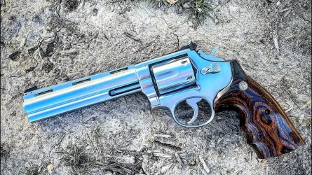

Another example... here's the muzzle of my S&W Model 63, showing that, like the new Colt revolvers, it too has a recessed crown. Unlike most new S&W revolvers, the new M63 has a 1-piece barrel.
