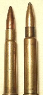

I reloaded heavy Nosler Partition .308 bullets for some old guy friends who were devastated when their beloved heavy Dominion hunting loads for their surplus Lee Enfields disappeared from sporting goods stores. I never had a complaint as they went on whacking the local moose, elk, and deer with those reloads I put together and sighted their rifles in for. I imagine the open base of the Partition obdurated sufficiently for the rifling to get a sufficient grip on it.

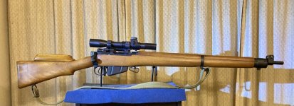

And of course, posts are often worthless without pictures. One of those two Long Branch rifles selected for Service Rifle competition:
