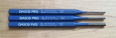

Just go to your nearest Ace Hardware or whatever and get a quality, base set of punches.
These three do most of what I want and I try them first before I go to my others. They were @ $12.00 and came in a cheap plastic pouch. Just these three work for most all pin drifting and magazine baseplate removing. Start with something like this and then later expand if you need too.
Jim
