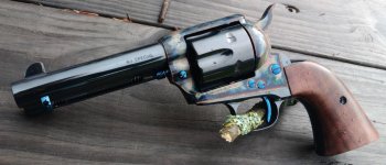

The .44spcl is my favorite caliber in the SAA. I don't have a Colt in that caliber anymore, I sold off the 3rd gen I had because I just couldn't warm up to the nickel finish. I far prefer a good bone/charcoal CCH finish. I've been looking for a nice Colt 4 3/4 SAA ever since for a reasonable price. No luck so far, they are a hot item.
I found this Standard Mfg. last year though.
