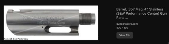

My guess is it has a PC 686 barrel swapped onto it, along with a lower front sight blade for the fixed rear.
That's my guess too, but I think it's a PC 681 barrel. A Performance Center revolver should have a PC logo on the frame, not the standard S&W trademark.
Numrich offered those barrels in the past.

As others have mentioned, the barrel has been swapped and is a 681 PC barrel. It is not a factory Performance Center gun or would have the PC logo on side of the frame like Chad mentioned above. Cool gun but definitely did not leave the factory like that.

The 619 and 620 were two piece barrels from the factory with a "light lug" profile that leaves the ejector rod exposed (like on a Model 10). The currently installed barrel is a one piece barrel, so the gunsmith who changed the barrel also removed the tabs from the frame to allow it to accept a one piece barrel.
Your barrel has a dovetailed front sight which will afford you a degree of adjustability that the original barrel's fixed sight didn't have.
It's not a factory Performance Center gun, but it looks like a nice shooter. Enjoy using it.
