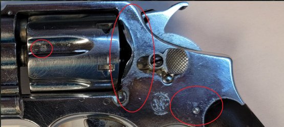

I'm struggling to find much information on this one since there isn't a model number so I thought I would ask on here for some help. It's been well used in its life so kind of wondering if it was a service rovolver or not also.

You have a .38 Military and Police (M&P) model (not a Model of 1905) from around 1923-24. There was no model number used at that time. I can't tell if the nickel finish is original, but I doubt it from what I see. See if you can take a picture of the serial number stamped on the bottom of the barrel.
Welcome to the forum. It's a .38 Military and Police model of 1905 4th change. Someone will be along with a proper date but imma say late 20's early 30's.

Without a B stamped ahead of the barrel serial number, it may have left the factory nickel plated at that time. Need additional opinions regarding that to verify.
Hi Jeffrey! Welcome to the forums from the Wiregrass! DWalt and firemanhank have ID'd your revolver. I see .38 M&P's with serials near yours shipping in late 1924 and early 1925. As DWalt points out, it appears it was nickel plated outside the factory. The biggest telltale is the hammer and trigger are plated and S&W made those in case colors. Many of the .38 M&P hand ejectors were used by police. It was a popular model from its initial launch in 1899. S&W also made around a million of them for the US and British forces in WWII. Its ancestor descendant is the Model 10 that is still being produced. Through all its engineering changes, about 7 million have been made over its lifetime.

This is a mid 1920's according to the serial number and the grips look original. The grips did not have medallions thru the 20's. Can't help you on the finish. I have two of these mine are a bit later 1926 to 1927.
Welcome to the Forum! You now know which S&W revolver model you own, and yes, it shows a lot of wear and tear. It has definitely been polished and re-nickeled outside of the factory at some point in its life- you can tell by the rough fit of the right sideplate seams, the "dished out" areas around the screw heads and stamped letters/numbers, and the nickel plated hammer and trigger. Without a letter from S&W, it's almost impossible to say whether or not it was a service revolver. With that said, if the bore is clean and your revolver operates correctly, it should be a fun shooter.
Welcome! Revolver age identification of the K frame Military & Police of the era hinges on two characteristics. First, is the MADE IN USA stamp, which was started in 1922 and the mushroom shaped ejector rod knob which ended in 1927. As note above, the gun has been refinished, maybe chromed not nickel? It shows areas of pitting that has been plated over the pits and the ejector rod knob has had the knurling buffed off.
The exact same two factors that led me to believe the plating was not original - the extractor rod knob and the appearance of pitting under the plating.
Definitely replated. It's hard to tell in a picture, but it looks like chrome to me, not nickel.
