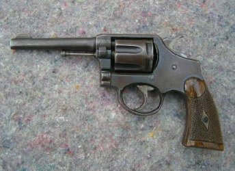

Need info on a .32-20 Spanish S&W clone
I believe a member of the forum was familiar with, or investigated a case where a killing occurred by firing a .32 long out of a 32-20 chambered revolver. Something I think would be unlikely for a deputy or someone associated with a deputy would do. But an outlying possibility..

Is yours chambered in .32-20 aka .32 WCF? For some reason he Eibarreses would label it '.32-20 "LONG" CTG.' They also referred to the caliber of their Winchester Model 1892 clone (El Tigre) as being chambered in ".44 LONG" Iinstead of .44-40, or 44 WCF.
"Fábrica de Armas Garantizadas" ("Guaranteed Wepons Factory") made three different model revolvers: the (Revolver) "Garantizado," the "Apache," and the "Rurál" (the letter á is accentuated in Spanish). I think yours is a "Garantizado." Neat revolver; thanks for sharing it in the Forum.
