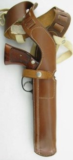

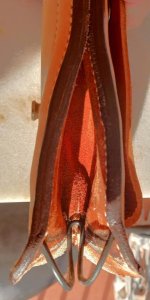

The spring inside these Bianchi shoulder holsters is so powerful that as the leather aged and softened, they often turned inside the leather and the holster collapsed.
On the other hand there are many that haven't and appear on eBay often. Here's a friend's in Canada whose is as old as yours and it is as-new even today.
Also, a view of the spring removed from my own for the 1911. Mine is also like new and was purchased to measure its spring power vs other designs such as the vintage Bianchi X-15.
Your should discard your holster because the collapse cannot be corrected and no longer reliable for retention. Gunleather makers never did expect their products to last 50 years and more although Heiser made such claims for their simple products ("no man ever outlived his Heiser holster").

I have two Bianchi Shoulder Holsters. I hated
those clamp springs so much.
What I did was release the tension by
carefully cutting the the legs off and
shortening the length in the bottom
leather. A cowboy boot repairer re-sewed
bottom for a better muzzle fit.
What keeps the Revolver in place is the
Retention Strap, and how the muzzle sits
down at the bottom. So much better.
Also the Rear Sight hole is re-cut to fit
better. A semi flexible semi soft cut to
fit piece of foam (removal) is used for
4” barrels. Take it out for the 6” barrels.
The Retention Strap goes behind trigger
guard for stability.
The Best to you and your Endeavors
