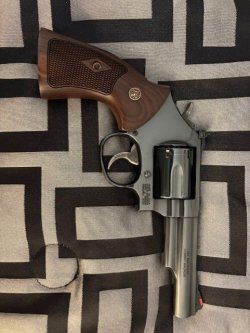

Asa far as I know, the only stainless piece on the new Model 19 is the barrel. The rest is carbon steel and MIM. Pretty looking revolver at least to my eyes.
