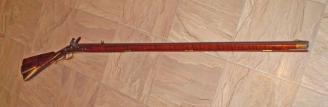

. . . oh . . . guess that I should mention that gun that exploded was mine, so accidents can happen to us all! It was a Chambers kit gun that I built a few years ago. We were shooting competition on a windy day and the targets kept blowing down. I went out several times to help set them back up and forgot where I was in the loading process. Before and after pictures attached.
