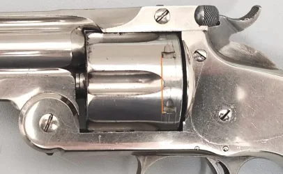

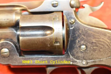

Look were the flute ends. If it is a short cylinder, the flute goes past the
start of the stop notched.
Notice the line cuts across the flute.

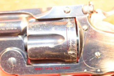

The long cylinder, the cylinder flute ends before the stop notches.
Now, here is the OP's cylinder.
The OP's revolver does have the short cylinder.
Cheers!
Webb
Cheers!
Webb
