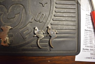

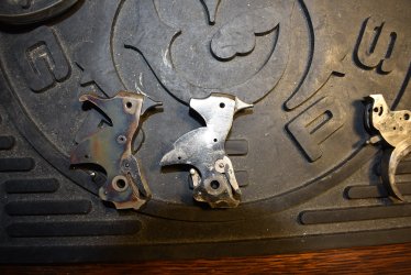

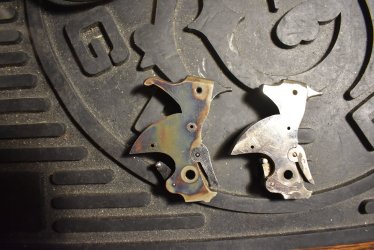

I bought this hammer and trigger set from another SWCA member a few years back and held onto it for a special project.
Well that project came about and I went to install the set in an early Triple Lock but they don't fit like I think that they should.
The hammer and sear engagement surfaces don't match and the firing pin doesn't protrude through the hole at all.
I have attached side-by-side photos of the original parts with the NOS parts. Thoughts?
It appears the hammer rebound seat has been removed on the shiny example.
