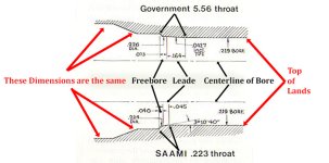

The difference is in the leade, the area in front of case mouth
that transitions from un-rifled, 'groove diameter' bore to
rifled bore.
The 5.56 has a longer leade, so can accept a wider ogive
slug, seated out farther than a .223 chamber.
The "possible hazard" concept comes from using 5.56
rounds in a .223 chamber, where the 5.56 slug might end up
contacting the rifling in the barrel, causing an increase in
resistance to the bullet getting started down the bore.
rifled bore.
I found these images that show the differences on blog.westernpowders.com
