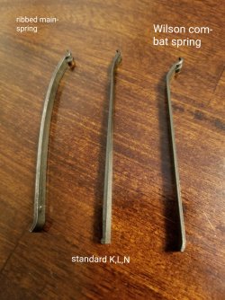

From weakest to strongest mainspring, its the performance center/ wolf spring, then the wilson combat spring. And the hardest is the stock mainspring.

These are leaf springs that can be tuned. You can add pressure or decrease it by simply bending them. A little goes a LONG ways. Ive received new Smith mainsprings that were too light and needed pressure added to get reliable firing. I think measuring trigger pulls is a waste of effort in a DA revolver and it being smooth is much more important. Lock time also is increased with a heavier spring. Lighter is not always better, especially in a revolver
