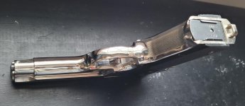

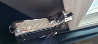

I picked it up today. All markings are crisp as are all the edges. There is no "N" stamped uner the grips. Pretty sure it's factory nickel but even if not it doesn't matter much to me. The gun looks amazing. Virtually no wear. Looks almost brand new. Beautiful pistol. I'll post some pics in a minute.
That nickel 59 you got looks factory. It probably would not have a N stamp on it being @ a 1978 example. That explains why my @ 1979 one doesn’t have a N stamp either, (as well as my @ 1978 nickel 39-2.) I wasn’t putting down Roy and it was explained to me by S&W employees from that time that he was in the revolver side. It seems he might have not known what they were doing including N stamps or factory “bobbed” hammer 39-2’s.
I definitely haven’t been following nickel 59 prices recently but you got a really nice one for a very good price. They have been selling for more at lesser conditions even without a box and stuff.

Looks like a legitimate factory nickel finish to me. That Model 59 also appears to be in fantastic condition, likely not fired outside of the factory test firing.
It probably was but it doesn't look like more than a box of ammo through it. I cleaned a small amount of carbon off the breech face and surrounding areas. Ran a brush and patch through the bore and it's absolutely pristine.
