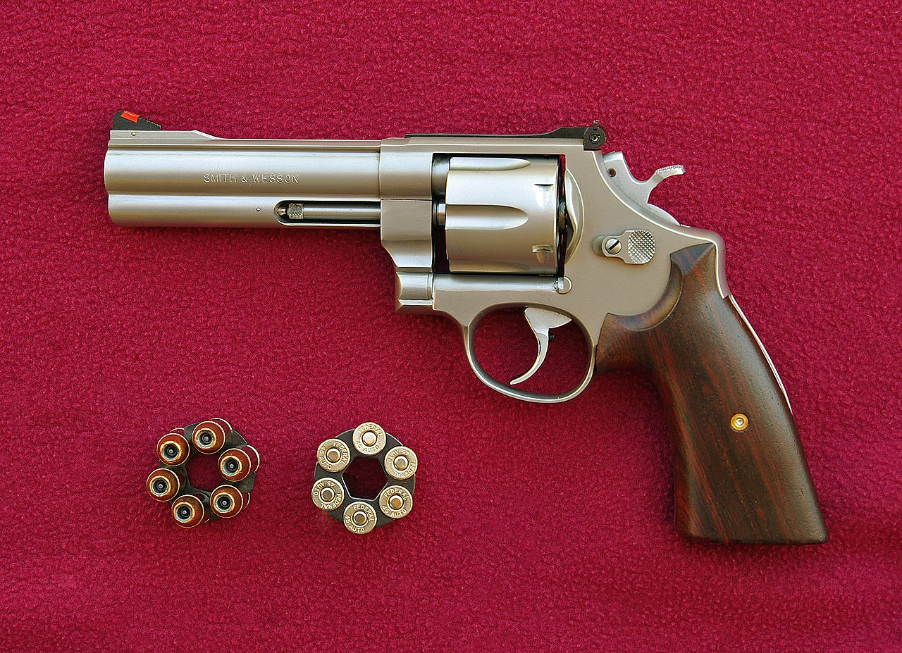

Nice thing about round-butt frames is that you can get conversion stocks that will make them look and feel like square butts. I did that with this 625-2 Model of1988. Now the gun feels way more comfortable and solid in my hand. Converting square butt guns to round butt style is much more complex and involves altering the frame.
