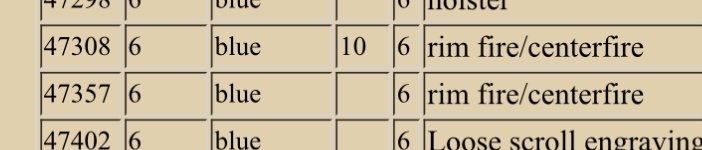

Pattern
I just found this in the Number 2 Army survey same serial number range.
Sure looks like a contract pattern to me.

I located other surveys that confirm the following serial numbers with the centerfire alteration.
Serials:
10452
10455
10782
25290
47298
47308
47177
53253
53565
70384
These serial numbers definitely follow a pattern of batch conversion. Notice also in the photos the exact same type conversion technique was used with a floating centerfire pin ( serial number 70384) The alteration is identical!
The pattern is now obvious in both batched serial numbers and method of alteration. This is not a modern alteration. Someone was consistently altering these Number 2 Army's in batches for some specific client for several years.

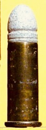

Cartridge reference
Here are some photos of applicable 32cf cartridges that would chamber in the Number 2 Army. They are very early pre-1880 cartridges. That is why a modern conversion to centerfire is not realistic.

The 32 Long Colt cartridge was originally loaded with an outside lubricated bullet. However, Colt later changed to using a bullet that fit inside the case and had a hollow base (much like a Minie Ball) that was intended to allow the bullet to expand into the rifling once it left the case. This allowed for a cleaner inside lubricated load. It was intended to be fully interchangeable with the old outside lubed bullets and continued to be loaded into at least the 1980's bu Winchester and Remington.
There is also a 32 Short Colt round which continued to use the old outside lubricated bullet. Any forearm chambered for the 32 Long Colt can also shoot the Short version. The short version was still available wholesale (Remington brand) as late as the 2010's though it may have been old stock. So, at least theoretically, someone who had one of these converted S&W No. 2 revolvers would still be able to find ammo that fit it.
There have been a number of posts on the Cast Boolits forum on loading for the old Short and Long Colt round. Seems brass is still available, at least some of the time. The majority seem to prefer the outside lubed bullet as being slightly more accurate and less work to cast (not needing a base plug for the hollow base).
These converted guns are neat bit of history, much like the cartridge conversion of old cap & ball revolvers. And they could have stayed in use for many years even long after more modern designs made the effectively obsolete. Still worked and ammo could still be found and for many users that was enough. I would love to find one, get some 32LC brass and load up some rounds to see how well they can shoot.
