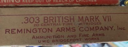

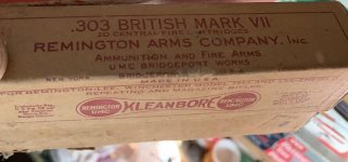

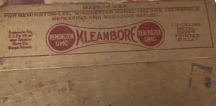

An old box of Remington UMC .303 British that was given to me years ago.
I am guessing that the box is from around 1900+/- since it says for Remington Lee, Winchester Model 1895 and Lee Enfield rifles.
It was filled with questionable quality Berdan primed FMJ reloads - not UMC cases. So I pulled the bullets and reloaded them in Boxer primed cases. Probably 30 or so years ago.
