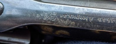

a few weeks ago i bought this smith and wesson 44 RUSSIAN. What do you think ? i am new member of the forum i don't speak english veru well . Serial number is 12XXX

Welcome! Technically, that would be called a Model 3 Russian, 1st Model even though it has the frame swell and larger trigger pin. The "Old Old" name is archaic and confusing at best, but the fact that a 2nd Model is called a 1st Model is also confusing. It seems that during the contract order for the 1st Model, a change was made to increase the size of the trigger pin and to add the notch to the hammer to lock the top latch in place when the hammer was at rest. Your revolver would have been part of the 20,000 contract guns made for Russia, most likely shipped in 1872. This Russian contract model is very rare in the US, with only few known.
The stocks of the gun are worn from sanding and are under-sized, not fitting the frame. The finish looks too fresh for original, since original finish guns from this era had a higher polish and yours looks flat. For some reason, re-blued guns often have a cylinder that turns plum color over time. I believe it is due to the metallurgy being different in the cylinders than the rest of the gun and not taking a blue as well. Adding nickel to steel, for example, toughens the metal but also makes it much more difficult to color.
Bottom line is that you have a gun that is has not been mistreated or damaged in use. It has very smooth metal and most likely just lost its bluing over time. Fortunately, the refinish did not include a buffing wheel since the stamping and the edges remain sharp, that coupled with the rarity means you still have a very nice and significant Smith & Wesson revolver.

Thank you very much for your answer . I think the finish of the frame is the original one but worn ( usé en français ) there is some traces of rust with cold re bluing
I'm not convinced that the gun's been refinished. I've seen too many antique S&Ws that have had their cyinders turn dark over time and were original guns. Regardless, that a very nice find and an outstanding example. Ed
I think like you. I examined it with a watchmaker's magnifying glass and saw no trace of polishing. it is impossible to reblue (refinish?) without leaving a mark on the angles. only the stocks are used
A very skilled polisher can refinished a gun and not leave any detailed indications of their work if the gun has no blemishes, pits or other damages that have to be polished out, and therefore leave polishing marks. The old time S&W factory gun finishers could repolish and refinish a S&W and I would defy anyone to point out any evidence of a refinish ( excluding the refinishing stamps applied to the grip frame ) . Ed

Frankly, although I think that you are right about the refinish, it was masterfully done to leave the barrel roll stamp so clear and all of the edges 'sharp.'
I believe that to be extremely accurate, you have a Model 3 Russian Contract (export) 1st Model 2nd series, indicated by the Cyrillic barrel roll ending in 'America' and the large trigger pin and trigger pin boss. The very first 'Russian 1st Model 1st Series' guns had the smaller pin and boss of the 1st Model American and 1st Model American Transitionals, and have much lower serial numbers than yours.
You are fortunate to have one with the original Cyrillic roll; Quite often, guns from any of the Russian contracts that show up in the US are 'rejects' that have had the Cyrillic roll removed and the US 'Russian Model' roll put on in its place, or were built to sell as commercial products and originally rolled with the US markings.
