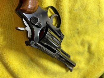

I second the Oxpho Blue and degrease with alcohol - use solvent alcohol, methyl or ethyl, not the drugstore isopropyl, which is diluted with water. Follow the application instructions, neutralize with alcohol, rub with 0000 wool, repeat, as many as 11-12 times until you like the result (and probably no change), and you will get a pretty good match to S&W 1960's-1980's blue.
You can find 91% isopropanol at drugstores. Any alcohol, even Everclear, that's above 90% should work pretty well. You almost never can find absolute alcohol outside of a lab.
