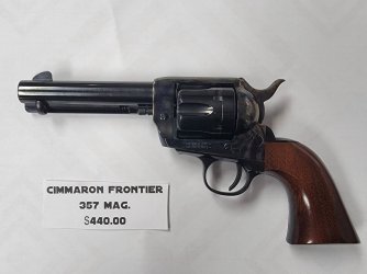

Tempted to pick up this Cimarron (Pieatta) Frontier in 357 mag. It looks fantastic except for a prominent turn ring. I examined it closely and I don't see what caused it. Maybe something got caught between the frame and cylinder? Or a bur on the cylinder stop that is gone now?
Anyhow any opinions would be appreciated.

I called the Cimarron customer service and that's what they said. I guess when a used gun is in a store, you can't control how it is handled.
I agree that that doesn't seem to be a turn line as it is not in alignment with the notches.

Well, I know why its got the turn ring where it is now. And yes I bought it. (not at the list price) The PO must have taken the cylinder out and not made sure the base pin was back in the right place. There are 2 notches in the base pin. There is a spring loaded base pin latch nut that holds it in . The first notch is where you normally have it and the second notch will keep the hammer from going all the way down as a form of safety. The PO obviously had the base pin turned 45 degress. If you shoot it this way the base pin will walk out as it is not held by the base pin latch. If you shoot it enough it will walk out enough to allow the cylinder to rub on the frame. When assembled correctly the gun is timed right and is very tight. I don't think it has been shot much at all.
I cleaned it and warmed the cylinder with a heat gun, applied a little cold blue on the hot cylinder and its acceptable as a shooter.

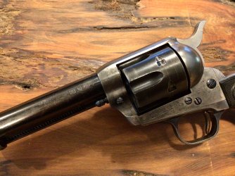

Cylinder line on a Colt Single Action style
revolver was not handled correctly.
People cocking a S.A. are not bringing the
hammer all the way back to full cock anytime
it is actuated.
If hammer is ever put on safety half court cock
always take the hammer to full cock and gently
forward to take off the safety notch.
