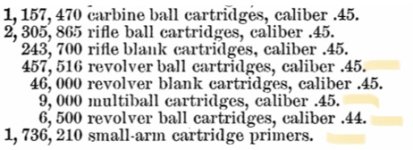

You’re very fortunate to have found a model 1 with the original barrel length. Almost 70% went to Government Surplus sales and most sold to American Express and Wells Fargo in two large contracts.
You can see during the year 1877 the Government was dealing with both the Indian wars and the Railroad Riots from coast to coast at the same time. The Military records reflect huge numbers of ammo, primers for reloading issued and damage to firearms/spare parts ordered.
Those guns issued to the Militia alone in 1877 included significant numbers of Schofield and 44 American revolvers. They also issued multi-ball ammo to the Militia that same year.
1.7 million small arms primers in 1 year alone! That’s a lot of reloading!!
105,000 spare parts for small arms! That’s a lot of repairs!!
Murph
