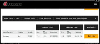

Use current data from Hodgdon. SEE PHOTO.
This is still worthless information! The question was which specific propellant are you talking about? ALL Accurate propellants have been made by several different manufacturers in different countries from Western Europe to the U.S. to Australia. Saying you are loading a St. Marks product is worthless information unless you specify the specific propellant number or name!
Its the same as if you said you are using a Morton product but are not specific. Morton manufactures many products from table salt to rubber to rocket propellants and boosters depending on which of the Morton companies you mean, Morton Salt or Morton-Thiokol. All the same parent company.
Just like DuPont! Are you talking about Nylon, Dacron, Kevlar, paints,or even Black Powder or other propellents (before those lines were sold) Or literally thousands of other chemical products?
Now do you understand what I was saying?
Data was posted above.Here it is again. Hodgdon data with St Marks manufactured data. FOLLOW CURRENT DATA.
