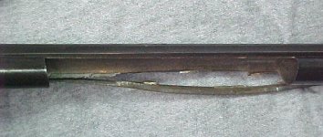

A pic attached is of a Parker 20ga Trojan set of barrels that let go in the left tube. The steel thickness is only approx .012/.015". That's very thin. An obstruction may also have been involved but the bores are oversized when mic'd also.
Also,, detecting a loose rib by ringing the barrels does work. However it may not tell you if there is a loose gap mid way in the rib. It is at it's best detecting a loose rib at the very ends of the rib where it can vibrate freely. But don't bypass using the trick in checking out the barrels, just visually check them very closely as well. Rapping the rib with your knuckle will also detect a loose one as it clicks against the barrel where it's loose.
