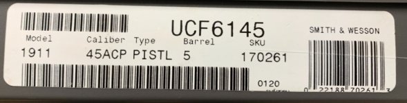

I've been after a S&W 1911 and recently found this one, SKU 170261. Interested in any thoughts on this particular model. Can we tell if it was built during the days of the "real" Performance Center, or is it a more recent iteration? Thanks.

That one runs the ragged edge of the end of the real Performance Center. When that pistol debuted, the serial prefix was "JMB" and yes, that was done on purpose. The other somewhat obvious difference in the early ones were the odd, non-standard hammer design. The original guns had a spur that was split, hard for me to put in to words but instead of one knurled spur, it had a left and a right side to the spur. I have no idea -why-, could simply be the taste of the supplier at that time.
One item that I've always found interesting is that the true PC guns going all the way back to the beginning (circa-1992) clear through to the very end (2008/2009) used the Briley titanium spherical bushing. And yet, the PC 1911 never did — at least while the PC was still in existence.
The later "PC" 1911 pistols (the red grip, blue grip and ones with cuts in the slide) did use the Briley bushing designed for a 1911.
If that pistol has an end label on the box or fired case envelope, you can be the judge if it came from the REAL PC or not. If it's 2007, I'll say yes. 2008 or 2009 and I'd say boy I don't know. 2010 or later and I believe no way.
I'd rather have the JMB prefix. However, I would much rather have this one than the red/blue gripped ones.
Box has the end label, but how would I tell from that? There is no date on it.
April 30, 2010 seems likely, given that "0120" on the end label.
Surprised that you don't have a fired case envelope in the box.
An e-mail to S&W with that serial number will probably return a similar date.
OK, so 2010, about what I would have guessed. Probably not a proper PC gun but still a decent piece. It's super tight, guess I need to get shooting.
Thanks guys
