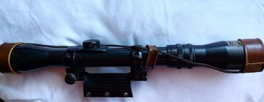

Picked up a odd older scope and mount....I think they may have some value
Jan 5, 2024
599
1,256
Central Florida
This was from an auction in Nevada with one dark picture. I bought it and had it shipped. Something told me to bid on it.
The scope is marked on the bell "GERMANY PECAR BERLIN VARIABLE 3-7"....Glass beautiful in it and has somewhat of an odd retical. I'm sorry about my poor pics but I couldn't get this phone to focus on the reticle design....Not being a scope expert, the reticle kinda looks like a 30-30 reticle, but the upper crosshair is very fine. It has a serial number on the bottom of the lens "54839", and it has its original leather scope caps with has a "PECAR" stamp in the end of the cap....It just feels like an extremely well made scope from the 50's.
The mount, rings are all marked "PARKER- HALE MADE IN ENGLAND and then BA 27".
From the best I can gather from searching, the scope mount was made by Parker Hale in the 50's for their own target custom Lee Enfield rifles... I have found some information on the mount and rings, but no prices. There are a few scopes like it listed, but they have no mount and don't seem to be cheap.
Anybody ever seen on of these? Again, sorry for these not so great pics.

Hard to tell from the photos, but if the side mount is flat where attached to the action it could work on an SMLE No4 type. Parker Hale did some nice work. The scope is definitely high quality too.
Just a SWAG but the scope is about $300.00 mount maybe $150.00.
I know only the name, not any details. They were fairly common back in the 50s-60s, probably not comparable to the higher end rifle scopes on the market today. Some probably had metric diameter tubes. You might look on eBay and GunTrader for value guidance, likely quite a few might listed there. I wouldn't get too excited about one unless I had some older classic rifle from that time period to mount it on.
From what I see on eBay, they are not actually selling for big bucks. Quite a few listed at fairly high prices but they are not selling.

From what I gather, these were made to go on Parker Hale customized SMLE No1Mk3 Enfield rifles. With the receiver design, there simply was no other way at the time to mount a scope on the rifle.
That I believe is a Post WW2 version of the Pecar. It was made by Koehler Optics in Berlin with the Pecar name.
Koehler made excellent optics.
These post war Pecar scopes were late 50's and into the 60's mfg.
IIRC they were a 26mm tube dia.. just over a 1" dia.
Several different reticle choices.
I'm not a 'scope guy but it seems these are up for sale for around $200 on the net with a quick check.
Don't know if that's a good price or not when compared to other offerings from todays optics mfg'rs using todays technology.
As said I'm not much of a 'scope guy..my latest scope sight is an Aldis Bros scope from WW1 mounted on a Geo. Gibbs Mannlicher Schoenauer 1903 sporter
The odd tube size can be overcome. Rings of about any size are sold. Some people by inserts and use still larger size rings.
The mount in the pic looks like it'd fit a No1MkIII SMLE. D&T the left side wall, though it seems to be a crime today to punch holes in any SMLE.
The easiest way used to be a Weaver one piece top mount ( T1 (?). 2 holes in the front ring on top and one in the top of the charger bridge.
Pecar scopes were made pre-WW2 and War Time as well. Those are in demand for their collector value especially the German War time use ones.

I think you are correct across the board...After doing research, I think the mount and rings are worth as much as the scope. I can't find a single one for sale anywhere on the internet. There are multiple older posts on forums asking where they can find one. Apparently, these were made specifically for the Park Hale No. 1, but were also used on No 1 Mk 3's.
