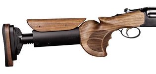

something I wanted to say earlier was when and where possible fit the gun to you. Depending on your pistol and discipline there may be restrictions but on something like a 1911 there are about endless options out there. Grips and trigger length are the 2 cheapest changes then mainspring housing and beaver-tail.
Look at some of the stock set ups used on shotguns on how those guns are fitted to the shooter and you wonder if the person is even required to be there, the gun should be able to point and shoot itself. The more natural your pistol fits your hand the better you can shoot with it.
