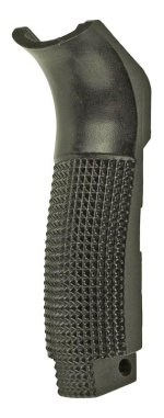

Here's a few shots. It came in a grab-bag of "pre-
3rd Gen" parts. Definitely plastic, confirmed by
shaving a sliver off with a single-edge razor blade.
Feels more like ABS than PA6...:confused: Steel
"U" clip is only metallic part.
Mounted on a 4513TSW frame, just to show size.

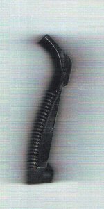

Is it a 669 grip insert?
I bought a few S&W 59-659, (and others,) years ago when they were available. I currently have one on a 59.
The first picture is from Numrich listed in 669 parts.
Jim

I honestly don't know what it's for :D
StanDDS mentioned in another thread that (all?) 2d
Gen backstraps were aluminum--if I'm not putting
words in his mouth.
:D He seemed interested in
drilling down :eek: further on what I had, so
figured a new thread was in order.
I'd say it's too short for a 59xx. It leaves a small
gap below the beavertail overhang, maybe thickness
of a dime, on the 4513TSW frame.
I only got into the 3rd Gens in this year, and have
less familiarity--like hardly ANY--with the 1st and
2d Gen guns. So, I can't speculate effectively
in a convincing manner, on what this is.
Tho I do have a 469 inbound...:D :p Wondering if
it'll be smidge thinner across the grips, than a 6906!
It looks similar to the back strap on a 469.
If you look closely you can see the piece in this photo.

S&W sold accessory back straps that were plastic, I have them on my 459 and 559, I've not seen one before for a x69, that would be a real find!
S&W sold accessory back straps that were plastic, I have them on my 459 and 559, I've not seen one before for a 669.
Well, that should answer the question as to whether S&W
made some in plastic, or no.
I'm guessing this one is for something shorter than the full
frame size pistols, but not sure if it's double or single stack-
width. I've got a 469 coming this week, will be interesting to
see if the OEM is plastic, or aluminum.
I think you're right, MACV! :D
I just pulled up auction shots and did a 'relative perspective'
visual overlay, and it looks like it'll match the beater I have
coming :D
Wonder if ABS takes paint...hmmm!
Plastic curved backstraps was a factory replacement part for the 459/659 pistols. Factory fitted for the 469/669.
I dare anyone to find a factory manufactured 645 plastic backstrap. As S&W never cataloged such a part.
The one fitted on that 4513, was a 469/669 modified part. What one would do for panels after that fitting is beyond me?
I just slipped it on an available frame, for size reference, for this
thread. ;)
