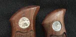

Is there an easy way to visually identify the plastic medallions?
Terry, it’s pretty easy to see difference and ID the plastic ones when they are in your hands.
Pictured for comparison, plastic is on right in both pics.
Easy to spot plastic rivot holding washers.
