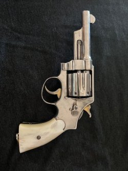

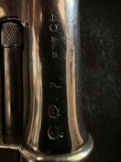

I bought this pistol on an online auction recently.
It was listed as a hand ejector triple lock first model,
converted to .455 mark II webley. 4.5" barrel.
Lots of markings that I assume are British.
Do you think it has been re-finished?
Where these commonly converted by various individuals
or sent to the factory. I have the original grips, but it came
with these cool pearl ones, so I had to try them out.
What would guess the shipment date would be?
Thanks for any information you could provide - - - New Guy
Looks like a conversion to 45 Auto Rimmed cartridge (45 A R) Most likely from the orig 455 caliber.
The new caliber marking wiped out the last '5' in the orig 455 caliber marking. Then the 'A R' was hand stamped added.
The hollowed out distorted shadow shape in the plateing shows where the metal was removed to make the change.
Polished and refinished to Nickel I believe. Some Gold plating on the trigger and hammer (?).
The bbl proofs are English / Birmingham Proof Hs marks .
They look like they may have gotten touched up a little by hand engraving after the polishing and buffing was done in that area of the caliber change.
The circles around each mark look irregular and broken as do the crowns above each mark.
There should be a firing proof on the Frame and one on the cylinder as well.
A View Proof mark (BV) may also appear with those.
But any of these proof marks may have been lost to refinishing or be so faint at this point that they are hard to recognize.
The circles around each mark signify the proofing of a firearm Not of English Make and that style of proof mark was introd
in the 1954 Proof LAw .
Prior to that under the 1925 rules, the gun would have actually had a small marking that said 'Not English Make'
Just my thoughts.
You have a .44 Hand Ejector First Model, aka the triple lock. Probably from ca. 1910. It was made in .44 Russian, .44 Special, .38-40, .44-40, and .45 Colt. I would guess from the caliber stamping the latter. About 15K were made. Yours has been heavily refinished. It is possible it could have been rechambered or modified for .455 but if so it is not marked that way. If a .45 Colt cartridge can be chambered in it, that is probably what it originally was chambered for. It also could have been later rechambered or modified to the .45 Auto Rim. That cartridge did not exist until the early 1920s. A good picture of the rear face of the cylinder might establish that. The barrel should be 4" or 5". Is it? Is there a number stamped inside the extractor rod recess? Those who are much more familiar with the early triple locks can hopefully provide you with better guesses than I. In its present condition, I hope you didn't pay too much for it, as it is more of a curio than a collectible.

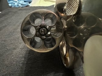

Not necessarily. The chamber mouths could have been recessed deeply to accommodate the .45 AR's thick rims. Not enough headspace to accommodate a moon clip. Exactly why I requested a good clear picture of the rear face of the cylinder, to see exactly what was done to it, if anything. There are several other possibilities.

I've included a few more pics of the cylinder and a
a couple (probably meaningless) stamps.

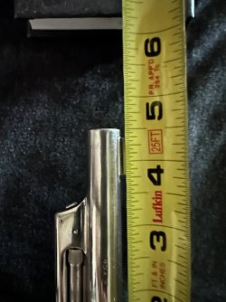

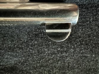

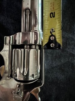

It is also a 4" not 4.5.

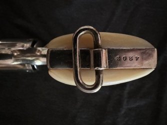

The only number I can find under the extractor rod end

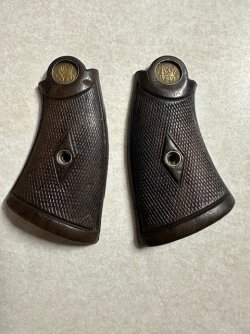

These are the grips that were on it.
Look original to me.
They well could be. That grip style was used from about 1911 to 1920. If the barrel is 4", that would probably be highly unusual. Or the barrel could have been cut. I am now thinking that it might be worthwhile to order a letter for it to see if some of the many blanks regarding original chambering, finish, and barrel length can be filled. It could be more interesting than I first thought.

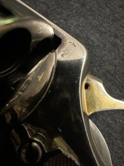

Clearly 4.5". It seems evident that a longer barrel has been shortened. 6-1/2" and 5" barrels are most abundant. I don't believe S&W made any in 4-1/2", unless by special order. The British Broad Arrow stamp on the top left of the frame indicates Crown property. Reasons why getting a letter might be advisable.

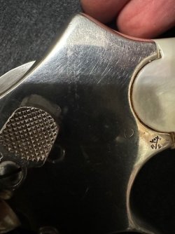

The stamp on the lower right edge of the left side plate is the Birmingham Proof Hs 'date code'
The mark indicates the proofing was done in 1951. That was likely for the revolver being passed into civilian/commercial sales. It would require such proofing. Also it would require proofing if any alterations like rechambering, bbl cutting, etc had been done to it.
The mark on the left side of the frame up high at the cylinder opening is the British Govt Inspection mark
BroadArrow for the Property of the British Govt.
Crown/A2/E is the actual Inspectors marking.
The A2 is the individual inspector
The E denotes it was done at the Royal Small Arms Factory @ Enfield.
This was done when the revolver(s) were received by the Brit govt , Inspected and Proof fired.
There is a very small 'Crossed Pennants' mark on the left side of the bbl ring.
That was the Brit Military small arms proof mark that was stamped at that time.
The cylinder w/o a ser on the back side certainly suggests some reduction there.
The extractor face itself has coarse lathe tool marks from what I might assume to be thinning it down
Going back to my first post about the proof markings.
The bbl proofs are from 1954 and forward. That by the style of the stamps themselves.
I left out that there should be the cart info (caliber & length of case in inches and the pressure in English Tons/inch sq) on the bbl. None of that exists on the bbl.
But..we now know by seeing the Birmingham Proof Date Code that it was commercially proofed in 1951.
Proofed under the 1925 Proof rules..different markings
Completely different proof law rules.
The Proof stamps should not be within the circles.
There SHOULD be the small req box with 'Not English Make' within it stamped on the frame.
There never would have been the cartridge info stamped on the bbl. So not being there now is not surprising.
That along with the funky hand cut look of the Birmingham 1954&>proofs that are on the bbl now, I suspect someone tried very hard to make it look the way it does.
Why, I don't know.
Maybe it's just a plain .455 and they went way out of their way to try and convince a future buyer it was anything but that.

Yours is converted by shaving the rear face of the cylinder (the serial number is shaved off), to shoot 45 AR. It will shoot 45 ACP with half or full moon clips but should not be used. The cylinder is not heat treated for the higher pressure of ACP. The lower pressure of AR is ok and the same as 455.
If you reload the longer 455 MKI cases they will head space on the shoulder in the chambers and stick out of the rear of the shaved cylinder about .040" more than if the case rim was seated against the cylinder face as it was designed before the cylinder was shortened Therefore they will still shoot in your gun as modified. The shorter MKII cases will not work without a spacer made by modifying a full moon clip, which you can use to shoot up the box of MK ll ammo you already purchased.
