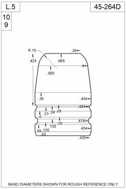

I load 3.5 grains of Bullseye with Accurate 45-264D for my S&W HE and Colt New Service for 650 fps. Seating depth is only .25" and the full diameter brand north of the crimp groove reduces jump when the shorter Mk2 cases are fired in normally longer .455 chambers. My max field load, not for top-breaks, is 4 grains of 452AA or WST, which matches velocity of the CIL 265-grain .455 Colts in Starline brass.
