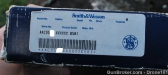

The hammer nose of my 581 is black like yours but the bushing is blued. I think the difference may be because my revolver was never sent back for a recall. The modifications were done at the factory and the gun was blued and issued as an "M" model. See the photo of the original box below.
