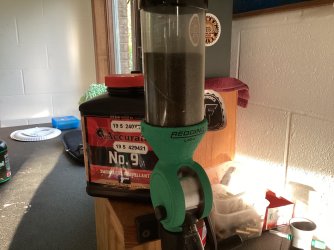

The RCBS uniflow owned has worked with all the fine grained powders used. AA9,7,5,2 H110, lil gun etc. It works well with unique, although hitches a little on occasion as it cuts through.

I find that fine powders like that measure well with any good measure (that doesn’t have a lot of slop). When in doubt I resort to an old Belding & Mull Visible Loader, slow but accurate. If you get a Harrell, your measuring difficulties will disappear… along with a lot of your dollars. Very pricey, but super accurate.
That powder is very fine and if there's any slop at all it's going in and caused binding. My Dillon measures do real good and so does my RCBS Uniflo. To be honest I've never tried it in my Lyman 55.
