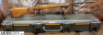

Lost my AR in a deep part of the James River, but had lots of .223 to shoot up, so last week I bought a CZ 527 Varmint with a set trigger.
I chose that rifle because they consistently shoot under one minute accuracy, have a fine trigger and a good free-floated barrel, a handsome walnut stock, all at a reasonable price point.
A friend has the same rifle in .204, and I loved shooting it, but didn't want to get into a new caliber, esp. with lots of .223 to shoot.
I lusted after the 527 MTR version, but it has a threaded barrel, and our legislature has banned threaded barrels on last January's anti-gun package.
A prairie dog hunt is on my bucket list, so can any of you here recommend a scope for my new CZ?
I've read and read, and it looks like the dealio for 100-400 yds is about 3x-15x 30mm, but there sure is a lot of discussion between FFP and SFP scopes, best reticles, pros and cons for each.
I searched our forum, found a few tidbits, but I'd appreciate any new input from those of you who "been there done that" in the past few years.

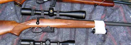

I have the same rifle in .204 Ruger, and like you said, its accurate and very well made. I mostly use it for coyote, sometimes ground hog.
Biggest difference between a FFP and SFP scope is the reticle on a FFP scope allows you to accurately use the reticle markings to range your target, and allow for bullet drop / wind at all scope magnifications. The reticle changes size as you increase magnification. The only problem with that is the reticle can be hard to see at lower power. SFP scopes usually only allow this at full magnification, as reticle size does not change. Maybe a moot point for your use, as I would think most shots at a small target at longer range are going to be at full magnification.
4x16 and 6x20 are popular. When you start to get above 16 or so magnification, heat and mirage can become an issue, effecting accuracy. The larger the objective lens, the better your exit pupil (the more light it lets in). 30mm tube diameter usually means more W&E adjustment in the scope.
If you want to go FFP, and not spend a ton of money, I can highly recommend the Vortex brand. Last year, I bought a 6.5 Creedmoor chassis rifle, and put a Vortex Diamondback Tactical ll 4x16 scope on it, and I am impressed with both. The scope features a 30mm tube, FFP etched reticle with a rather complex series of hash marks, and an accurate and good feeling set of target type turrets in case you rather account for distance and wind that way. ED glass helps ensure a sharp and clear view. Lifetime warranty. A lot of scope for about $325.00. Color me impressed.
My CZ wears a Nikon 4x14 SFP with a simple BDC reticle, and also works well, but the Vortex is a better long range, small target scope.
Wanted to add that I recently picked up a Bushnell "Nitro" 4x16, 30mm tube, SFP scope for use on an AR-10. It has the "Deploy" MOA reticle. It is a VERY nice scope, bright and clear, with accurate adjustments. Best part is right now Natchez Shooting Supply has them on close out for about $200. Lifetime warranty, and a heck of a deal at that price. They are not the cheap "blister pack" scopes people think about when they think Bushnell. They have the FFP model on sale as well for only a few bucks more. And whatever you buy, make sure it has either a side or front adjustable parallax, an important feature for good long range accuracy.
