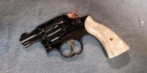

Sent in last November returned today , Master Blue with case color hammer , trigger and locking bolt fitted. Ford's Custom Plating Crystal River , FL

That M10 looks great. I really like the case hardened hammer and trigger.

How's the side plate seam? Hard to tell from the pictures. I had them do my 14-1 in master blue, but they polished the side plate off the frame and I ended up with a more visible seam than I like. That's my only complaint…the finish is stunning.

Glad to see that Ford's is still capable of good work. I'm also interested to see how the sideplate seam looks up close, but all in all it looks like a nice job.
Seams fit fine the only thing is a very small amount of pitting in the edge of blast shield and frame on right side.
