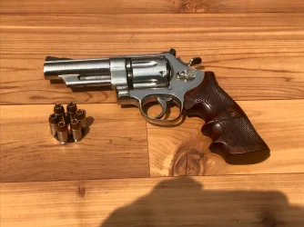

It is only an assuption, I've seen three now that were both shorter and rounder on the bottom. All were on 3.5" 27s or pre-27s - but I have no evidence they weren't all modified. They all were identical to that 4" in the OP (I agree BTW that that gun was cut back - perhaps by the factory). I have a 4" 25-2 that was done that way with the factory modification stamp.
It came (in 1974) with factory target stocks but they were standard.
They were at different gun shows but all in my state so they may have been done by the same guy - whoever it is, if it is an individual I'd sure like to find him.
Then again, I've got a similar set on my 624 that definitely aren't factory. For one thing they are Maple. I got them off an eBay auction.

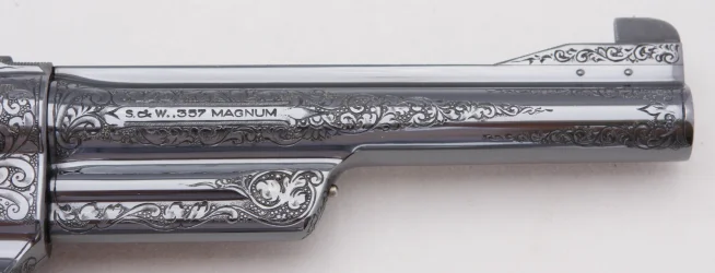

I will not doubt your assessment, you know much more about them than I, but if the barrel has been shortened, it seems the barrel roll stamp is still centered properly between muzzle and frame. My 6-incher from 1978 has the roll stamp centered over the spot where the ejector shroud tapers back to the barrel; if it were to be cut back to 4", the roll stamp would be way off-center and end almost at the muzzle. Even a 5" barrel cut back to 4" would have an off-center roll stamp. Your thoughts?
Asking if there are "pre model enthusiasts on here" is like asking whether there will be ants at a picnic. I'm not up on the specifics as well as others here but if I were to see that beautiful 5-screw .357M in a display case, it would go home with me regardless of the modifications it might have.
Great observations and I agree with your points and that I could be wrong. We are working off only one photo. To further your point, the front sight pins are also in the right place in addition to the roll marks being centered on the 4" barrel. Interestingly enough, while you were posting your thread I was searching my photos of pre-27s. What I found is that roll marks were a little all over the place on the early post war Magnums.

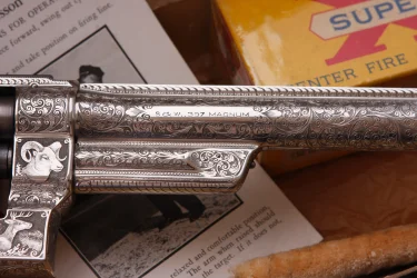

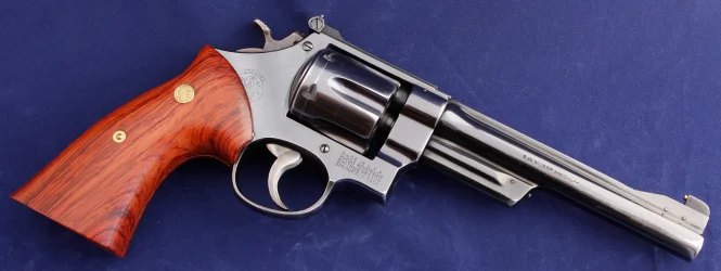

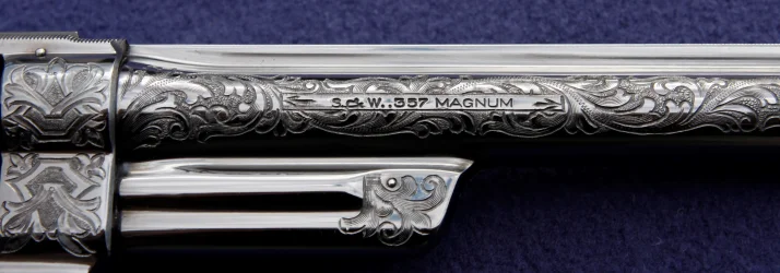

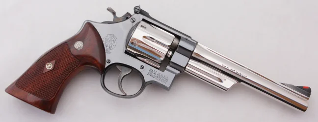

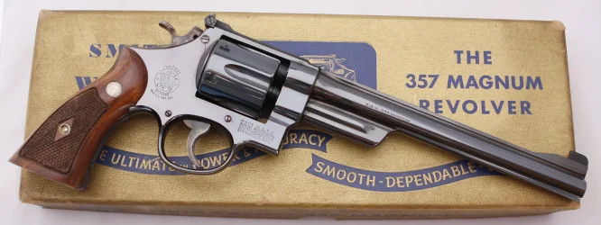

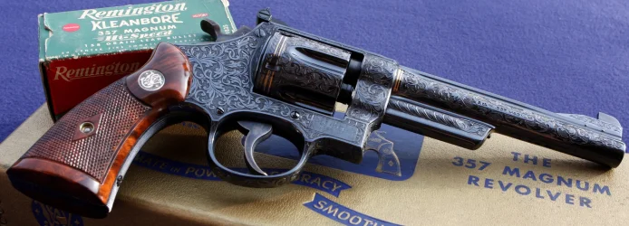

Roll Mark on an 8 3/8" pre-27
another 8 3/8"
another 8 3/8"
... a 6"er
a 6.5"er
another 6"
another 6.5"er
I hope that it is a factory 4" pre-27 and that we have found one more to add to the database. To make a proper assessment I would love a few more photos (front of the barrel face, a close up of the rib where it mates with the front sight, a serial number and any other photos).
The gun in the OP is a great gun regardless. :cool: I like it a lot and would love to have it in my collection as it would fit perfectly with my modified guns or factory original S&Ws. I would certainly keep it on my auction watchlist and agree that were it in a case in a gun store for sale, I would have a hard time leaving it there.
Thanks for your astute observations. :)
RK, those are some amazing engraved guns, I can't imagine the time it took for the engraver for each gun. Closest I have to anything you show is the 5-screw blued 6" with the smooth presentation stocks. I found an ANIB M27-2 in its case with all the goodies about 5 years ago. It Letters to Washington's Birthday, Feb 22 (but 1978 and not 1732 :p ). I never got lucky enough to find a '50s or '60s era M27.
