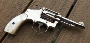

I bought this 1920 M&P 38 special about 3 years ago and paid $350 at a local dealer. It was pretty dirty and the action was stiff from dirt and old oil. I thought it might clean up nicely and I was right. The nickel is excellent and the action very smooth. The pearls came on it and they’re in beautiful shape. I’d now like to find one in this shape in 38 S&W and one in 32 S&W Long. I just have to keep looking.
