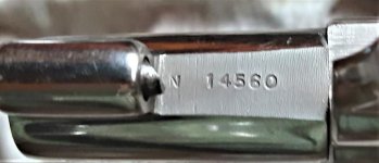

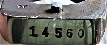

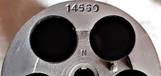

Referring to Gooney's comment about whether it's factory original
nickel, check three places for an N (see photos). If you see them,
it's an original factory nickel job. If they aren't there, it's been
refinished.
As for ship date ... based on many others in the database,
September-October 1953 most likely, but could be into February
1954.
It has the correct for the period third flat thumbpiece, easy to
detect because it only has 10 ridges and 11 valleys.

It appears that you have an early Chiefs Special, often called a "Baby Chiefs". Yours likely shipped late 1953 / early 1954. I have SN 36052, also a nickel finish, which is likely close to yours. The earliest ones shipped generally in 1951 with a 1/2 round front sight. Shortly after that, perhaps 1952, the front sight changed to a smooth ramp. And shortly later in 1953, the front ramp took on a serrated appearance. Late '53/ early '54 brought on more changes with the loss of the front trigger guard screw and the enlargement of the trigger guard. Obviously there were a lot of changes prior to model numbers being assigned.
Your piece looks nice. As Goony mentioned above the nickel finish can be verified with a factory letter or some more pictures provided by you. I see an indication that yours "might" have been refinished, but it is not a call I would make based on what I have seen so far. Give us some more pictures and look for an "N" marking in several places such as the left side of the grip frame, on the cylinder under the star, and on the barrel flat. That will help tell us that it left the factory in nickel finish. I'll attach a couple pictures for you.... Nice looking one you have there. I'm sure our resident expert Bob, Two-Bit Cowboy", will soon be along to fill in some gaps. (All I know I learned from him.)
