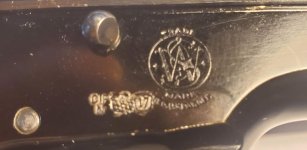

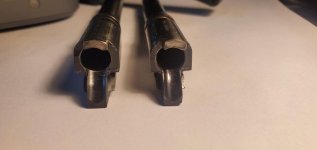

I just acquired a pre model 39 that is stamped both 9mm CTG and 9x21 on the barrel. The gun itself has proof marks on the frame , slide and barrel so we know it was once overseas. I have included a picture showing how a 9mm cartridge seats in a regular 9mm barrel (left side) vs the 9X21 barrel (right side). While the 9 mm cartridge will fit in the 9X21 barrel, It is not recommended to be used. Other than bullet seating, the only noticeable difference is the lug under the 9X21 barrel is machined out differently. It appears I can swap out a 9mm CTG barrel in this gun and it would fire the 9mm cartridge. I have data on Model 39's with the .30 caliber barrels but have not seen anything on a 9x21(IMI) I will be sending for a letter to see what information I can find as to original chambering and where it was shipped. I would welcome any information about this gun or cartridge.

The case is 2mm longer but the bullet is seated deeper so the OAL is the same as 9mm P and the ballistics are the same.

Kevin, Here are some pictures of the proof marks, CIP/N, A shield & a 17

German commercial proof marks. It is CIP/N (replaced the Eagle/N about 2017) and the cross-hatched shield is for Munich.
Thanks for the validation on the proof marks. I came to the same conclusion. Getting ready to send for a letter, unfortunately it is taking several months to get one issued.

Interesting that it has no Swedish proofs but does have post 2017 German proofs. I wonder if Widforss H.A.B. would respond to an inquiry
I believe they only proof mark the gun when it is shipped back to the U.S. and since this one somehow made it to Germany before it was returned, that explains the marks. I googled Mauritz Widforss HAB in Sweden and found some links so I am going to try and contact them for any information.
