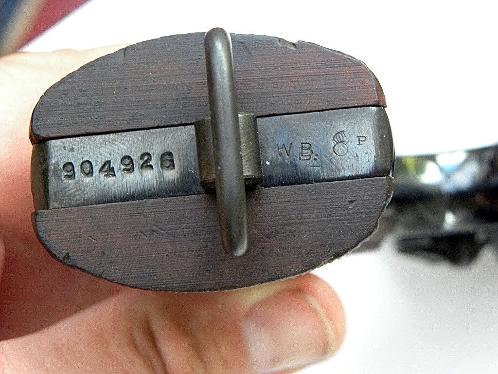

The serial No is 904926 it was inspected by W.B (Waldemar Broberg).

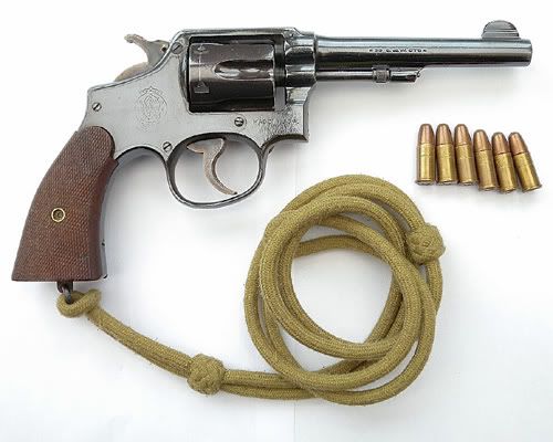

Here's Daz's photo:

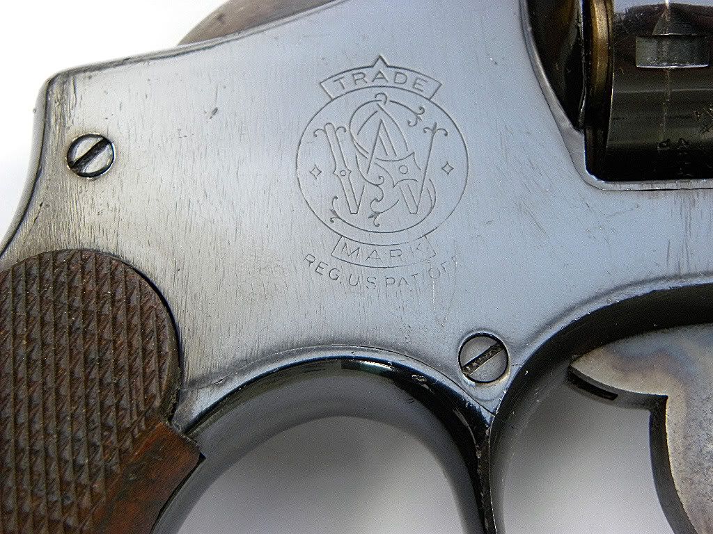

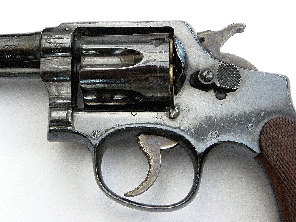

Does this picture help any?
I wish I could add some useful info for you, but at the very least I would like to say it's a good looking piece from what I can see. The checkering on the stocks makes it look like an aftermarket set or somebody went to the trouble of checkering them after they recieved the gun. Also, the screw just behind the trigger appears to be a flat head where it should be rounded but not a big deal considering its' military background.

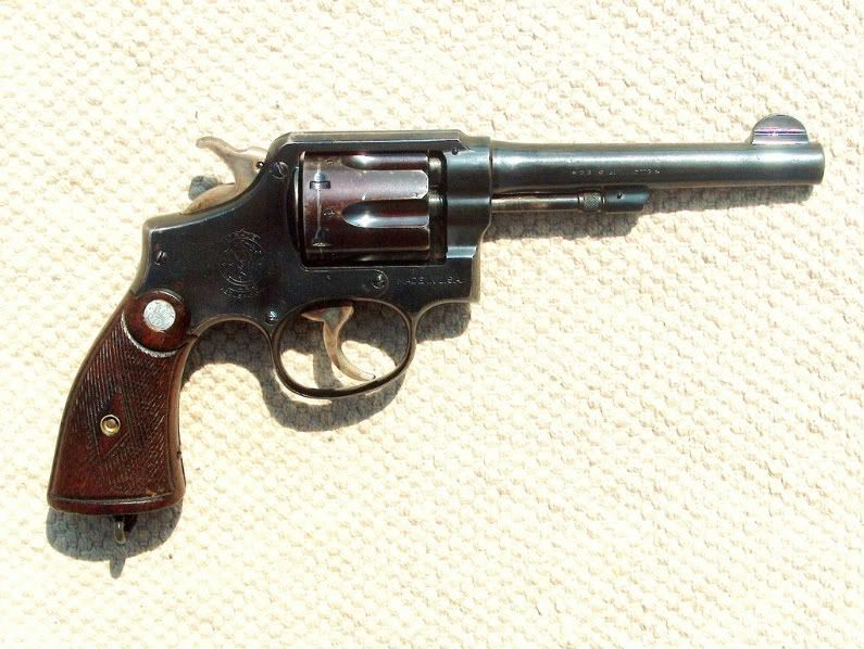

I have seen those type of grips before, I think I still have them somewhere. At one time I believe Sarco was selling them. Anyhow, this is a pic of my gun sn.818xxx. It has the correct early blue finish these came with and the grips are numbered to the gun. Hope this helps in some way.

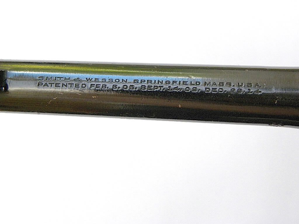

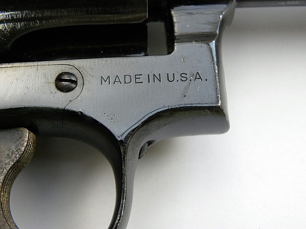

I'd like a closer look at the S&W addess on the OP gun. I'm probably seeing things in that blurred area, but it looks more like the postwar address with the Marcas Registradas marking and the other stuff. All the .38-200's I've seen have just the Made in USA marking there.

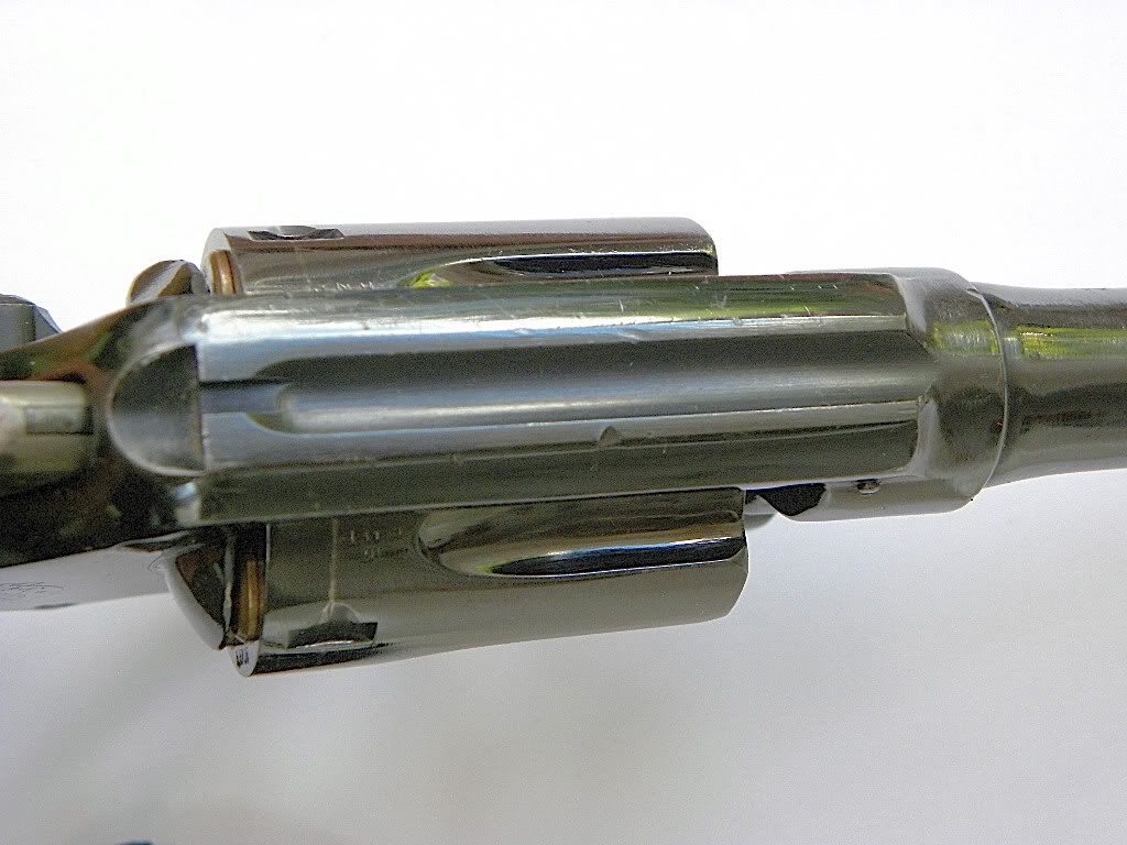

I don't see a four-line marking there, looks more like some corrosion or an uneven paint application.
Hi thanks for more info/comments the blurry area is infact reflection from the sun when I took the picture, will take some more close up ones today and get some kind sir to post them on here for me.

Looks like it had some fairly coarse Sanding, followed by a very fine high Polish gesture, enough to polish the surface of the coarse sanding gouges somewhat...rather odd...

The gun is certainly a refinish, the "Black Magic" finish refered two is a dull phosphate finish akin to Parkerizing. The gun also appears to a small amount of pitting under the present finish. When these guns were refinished post-war the goal was to make them look reasonably presentable for resale on the civilian market. The grips on the gun were very common on these post-war guns in the civilian market.
