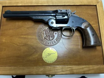

Posting this here because the revolver fits the time frame. Anyway last week I purchased a S&W revolver that came in a different type of Presentation case along with a plastic box.
It has a felt? covering over a fitted foam liner. It is NOT the same as regular presentation cases. The cloth covering is deteriorationg and the adhesive has broken down, the foam itself is in good condition. Randy @RT44nut fixed me up with some traditional case liners. Not sure if the liner can or should be flocked; should I buy some cloth and adhesive since that's closer to what was original.
Y'alls thoughts?
According to the "SCSW 5th Ed.", S&W's Performance Center only produced the Schofield Model of 2000 for about 3 or 4 years (2000-2003). Yours looks to be in excellent or ANIB condition. Most of the mahogany presentation cases that we're used to seeing were made from around 1960-1981, and those had blue flocked inserts. There were some with a blue satin lining, but I believe they were mostly for early Model 57s. More recent presentation cases were provided with PC special releases and commemorative revolvers or as a special order item. I do not know what type of cloth liner material was used in your presentation case, but I would suggest finding something very similar and gluing it in place as opposed to applying flocking. Hopefully some of our more knowledgeable Forum members will be along soon to chime in. Good luck!
I did one of these several moths ago, completed picture below. I purchased cloth that was very similar to the original from JoAnns fabrics who is out of business and glued in place. I would not recommend flocking on soft foam.

Looks like I'm going to give it a go with felt and glue.
You did a super nice job on that one.
