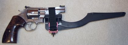

But forget mounting it on a very short revolver or a double barrel gun.
I have mounted one on 4" and 6" revolvers though.
