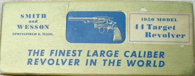

Regardless of when the gold boxes first appeared, they would have to have been designed earlier, perhaps at a time when available advertising artwork consisted almost exclusively of prewar designs. I have never really looked at later gold boxes to see when (or if) the short-action models began to be pictured instead of the ones with older hammer profiles.
.... I have always found it interesting that many of the early gold boxes show transitional hammers.
The first one that comes to mind for me would be the boxes for the Model of 1926 .44 Military. Then, later, those boxes were over-labeled with "Model of 1950" labels. Here's an example:
Mark

Nice, guns, and yes, should be the gold blued lettered box, as the pictures show and imply and as we have seen over the years, seem like the larger frame guns ran (shipped) longer in the maroon, as well as red boxes...again NICE guns and great pictures as usual, you and Doc take the best pictures
