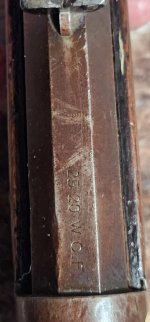

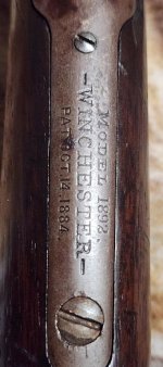

I agree, the old Winchester is an artifact, a tiny piece of history and the basis of my gun collecting. A simple coat of Renwax will preserve the wood, which seems to be a bit fragile. I will take it to the range this week and see if she shoots as good as I think she will. I will post a range report. I have some new gas sealed cast bullets that are pushing me to try them out.

I found a nice Winchester M1892 at the Southern SXS shoot last spring. Wish I could see well enough to use the iron sights
Some things you have to buy when you find them. This past winter I traded into a nice old Model 92 Winchester in 25-20. Shortly after bought 2 boxes of factory new 25-20 ammo and 150 pcs of new R-P brass for same. Paid $150 for all of it, which was a listing on an online classified site. Last week bought 150 pcs of 75 gr jacketed .257 cal FPs at the York show for $30 and today I came home from a local Fish& Game gun show with a LNIB set of RCBS dies for another $30. Managed to stumble onto all of it in a relatively short time. Luck helps too.

When I bought the 1892 Winchester I also bought two Parker shotguns from the same person. I had dies for the 25-20 and some brass. I sold the two Parkers at a profit and basically came away with the Winchester for free and put cash in my pocket. I could use some more brass as I only have 50 pieces.
