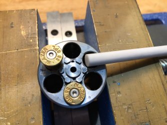

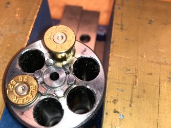

Just an amateur but this is how I do it.
Pretty easy to do. It's a simple hand-driven cylinder chamber chamfering tool with a caliber specific pilot. After the primary chamfering, polishing with a burnishing bob and finalized with a Spyderco ceramic cylindrical polishing tool. Here's a M65-3 treatment. As mentioned, remove the extractor and only use cartridges with expended primers!
