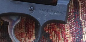

Pictures as promised. Bore was OK. Clean now. Chambers were really dirty but they sparkle now. They were NOT reamed for 38 special, thank you.
I just noticed it is marked FTP, not FTR. Charles Pate does not explain that. Possibly a mistake??
All numbers match in all the right places.

Looks to me like a light strike on the descending stroke of the "R". Nice representative example.
Poor strike on the R in FTR. Poor stamps, proofs, and even serial numbers on arms used by the British and commonwealth military are a "feature".
