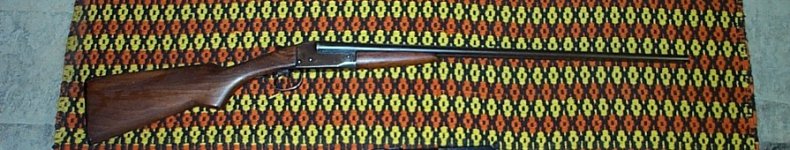

I have a 1924 Flues serial 391xxx field grade which I dated to 1924. Came with the canvas breakdown case and wood cleaning rod. Stock is dark next to frame from oil over the years but no cracks that I can see.
I hunted pheasants with it and shot some skeet over the years. Knew nothing about the shorter shell length and shot 2 3/4 shells without any noticed issue. Would lengthening the forcing cones be an improvement ?
