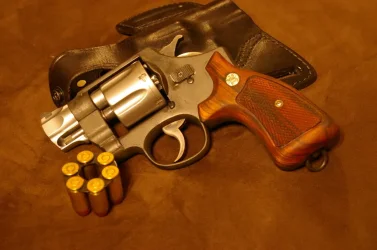

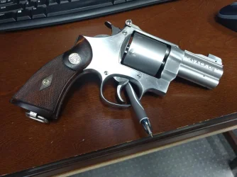

Sounds like it's strictly shooter value at this point. But I've also heard stated that any early N frame that functions properly is worth 5 Benjamins. Would be a keep and shoot or a strong candidate for a custom pre-war. These 2 both came to me as modified Brit 2nd Models. The top has a 625-10 barrel and cylinder with all new internals (with a Performance Center style ball detent front lock). The second uses parts from some other dash Model 625.
